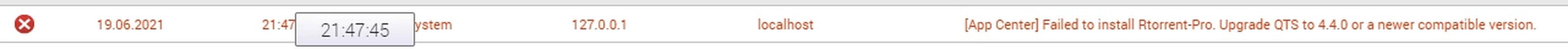

  1. # FW Minimum required version
  2. QTS_MINI_VERSION="4.3.0"
My NAS: TS-469L with 4.3.4.1652 and installed Version 0.9.8-B000
Try to install 0.9.8-B555 Installation cancels with:
Failed to install Rtorrent-Pro. Upgrade QTS to 4.4.0 or a newer compatible version.

error information/log/screenshot or it did not happen !
After install (Screenshot ist in German):
Translate: The following items could not be installed. Please refer to the system logs for details.
And the System Logs:
The Version B000 runs fine since Jan 10, 2021
