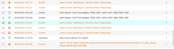

    The UI was mostly empty and settings menu went back to the earlier screenshot. The QNAP log also gets spammed full with these relaunch messages

    I removed rtorrent. Re-downloaded rtorrent Renamed my old rtorrent download dir to rtorrent-old (I switched to using the Rdownload share for V16) F12 > deleted all forms of storage for rtorrent from the browser Re-installed rtorrent It worked...
