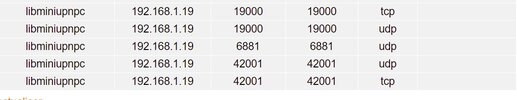

Ok I set back Upnp and all seems to be ok on my router (see pic joined)
But rtorrent say my port is closed...

since your VPN provider does not provide port forwarding, all is fine.
change provider to one that allows such.
if you open ports on your router (as UPNP does) and tell rtorrent to use direct internet connection - you are not covered by VPN , thus "vulnerable".
