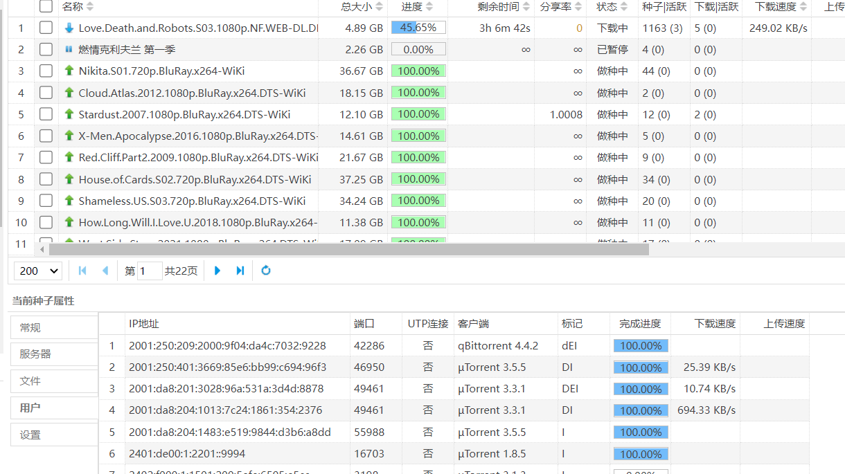

I tried on my NAS with a torrent that only supports ipv6 users.
The same torrent has speed in Transmission but can't link to the tracker in Rtorrent-Pro(both 0.9.7 and 0.9.8). Tracker: [Failed binding local connection end]
This is Transmission. Very fast. biubiubiu
This is Rtorrent. No speed....
